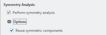

When selecting the “Perform Symmetry analysis” option, Creo performs a symmetry analysis to identify existing symmetric and antisymmetric components. These components can be reused instead of creating new mirrored models.
Be aware that there is no Symmetry Analysis on the following components
  • Skeletons
  • Non-geometric simplified representations
  • Assemblies with excluded or non-geometric simp rep components

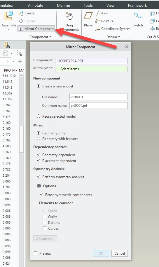

2-Explorer
May 16, 2024 12:24 PM UTC
Where is that function?

2-Explorer
May 16, 2024 12:35 PM UTC
Replying to StephenW
Thanks for the quick reply!
Do you know if there is a feature to check the symmetry of a part?
