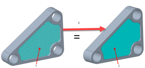

Image: Creo 6.0.0.0 uses homogenization methods to facilitate the modelling of large lattice structures by computing and providing Creo Simulate the equivalent homogenized material properties. 1. Lattice structure; 2. Homogenous Continuum; 3. Process of Homogenization

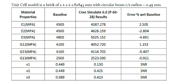

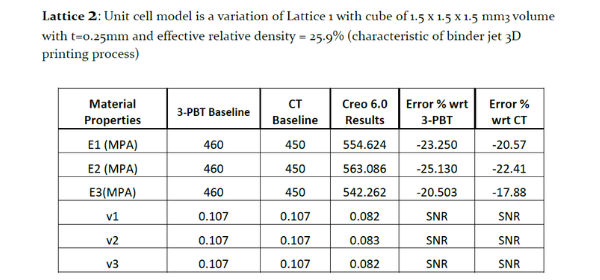

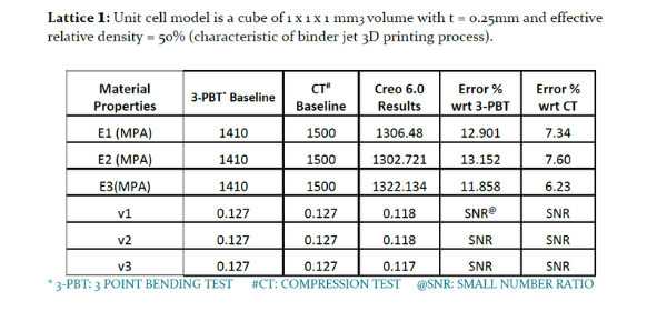

We compared Creo 6.0.0.0 results for three lattice structures and all of them compared very well with baseline. The homogenization results converge when compared with full lattice geometry models. As you can see in the table below, the error declines with an increase in the number of lattices in a given volume.
