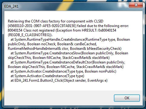

I completed one CREO-CUSTOMIZATION project using VB-API. Now i want to deliver ".exe" files to the customer. Do we need to tell them to "SET ENVIRONMENTAL VARIABLES", RUN "VB API REGISTER.BAT" file. as we did to create connection between CREO and VB.NET.
I run the Application file in one of my colleagues machine and it shown an error message. Please see the attachment to see the error.
Jun 15, 2017 1:20 PM UTC
Customer System should set with Environmental Variable & Run vb_api batch file,  then only VB API application will work
Jun 15, 2017 3:15 PM UTC
Thanks Parthiban Kannan‌
Now its working in all machines.
