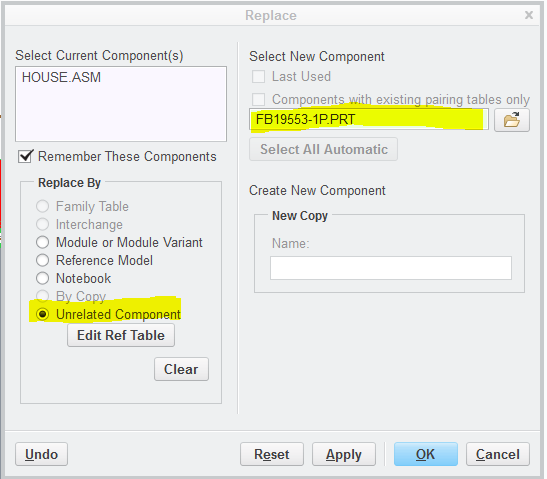

Asking for enhancement to Creo Parametric to have API access to Replace Unrelated Component:

Although you can't really do this as easily as you would in the GUI, you can already do this using functions already in the API.
When you get a chance, check the feature element tree for a ProAsmcomp. (/protoolkit/protkdoc/api/proasmcomp_h.html)
Essentially, once you have a selection to a component in your tree, you could use
  • Get the current constraints of the ProAsmComp
  • ProFeatureElemtreeExtract to get the feature element tree
  • Change the element for PRO_E_COMPONENT_MODEL using ProElementSpecialvalueSet
  • change the elements for the constraints as-needed to be references from the new model instead of from the old model
  • use ProFeatureWithoptionsRedefine to "finish" the feature
Its a bit of a pain... but I believe it can technically be done . Let me know if you need more-specific pseudo-code. It can be done similarly using the OTK APi if you need that one instead, but I don't have as much personal experience with that APi yet.
