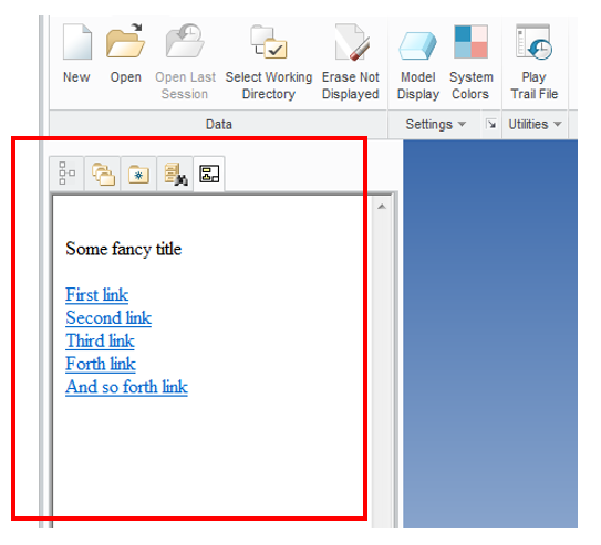

Mark,
You might consider using the input text file to generate hyperlinks within an HTML file. You could then create a new tab in the navigator pane to display the generated file. Similar to the screen shot below.
Just a thought...
