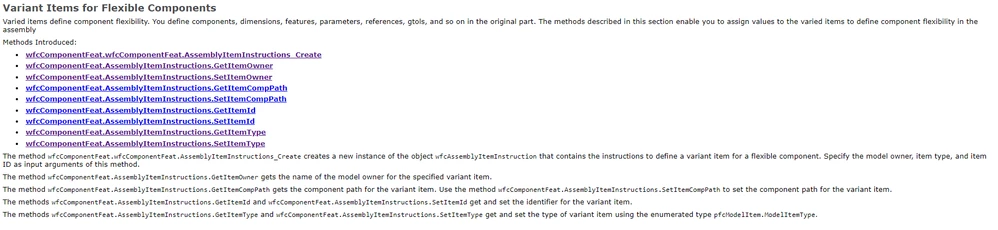

December 23, 2019
See chapter in User's Guide "Variant Items for Flexible Components"
VladiSlav17-PeridotAuthor
December 23, 2019
Hello!
I watched
But I couldn’t do what I wanted to do.
Regards!
