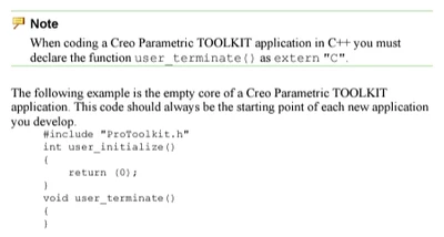

Is there anything like this for VB API. I've found it in user guide for TOOLKIT.
I'm able to start and use scripts that I have for now by running them in visual studio but I can't register application in creo.
