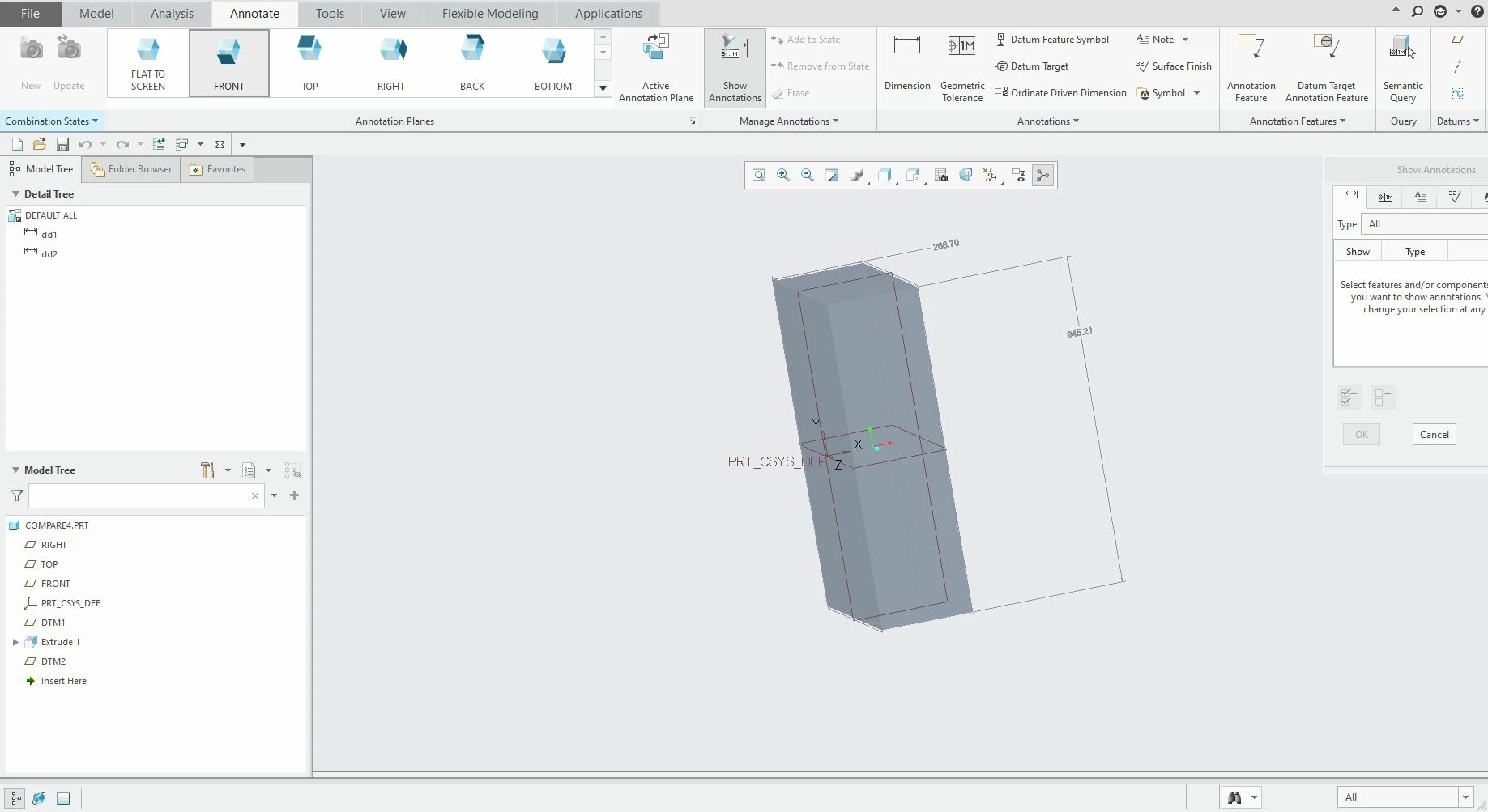

I have created dimensions in creo for a prt and successfully exported step files using AP242 protocol and I able to see dimension both in creo file and step file (refer dimensions.jpg)

I think there is no API for step models. Step is ISO standard textual format.
What you can do is to export AP242 with annotations and create som step parser and pair step annotation with specified dimension in creo model.
But I do not know what would you pair annotation based on. You will have to learn how is step structured.

Okay seems like their's no option ti do this without having develop our own parser.
Thanks @sjuraj
