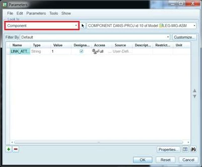

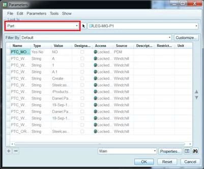

In WF I am able to create a parameter/attribute on the relationship/link between an assembly and it's component. I know this new attribute is not on the component itself (see below screenshots). In both cases below, I selected the same part/component in the assembly.
[cid:image001.jpg@01CF0D4A.4ABBDB00] [cid:image002.jpg@01CF0D4A.4ABBDB00]
How can I get access to this component parameter in Pro/TOOLKIT? What modelitem do I need to acquire so I can get the parameters?

Hi Patrick,
I think the component parameter is a feature parameter. Because the component is a feature type. So you need to get the feature link to that kind.
pro_error_fpar = ProSolidFeatVisit((ProSolid)mdl, (ProFeatureVisitAction)deleteKEParameterVisitAction, NULL, NULL);
ProError deleteKEParameterVisitAction(ProFeature * p_feature, ProError perr, ProAppData pad) {
ProParameterVisit(p_feature, NULL, deleteModelParameterVisitAction, pad);
return PRO_TK_NO_ERROR;
There you should find the parameters. Be sure to check if the feature is from type component feature.

Hi all,
Patric Eike is right. An assembly component should be treated as a feature.
You should pass ProAsmcomp as ProModdelitem to parameter functions.
To get to ProAsmcomp would be from ProAsmcomppath - there are a lot of examples in user manual.
If you have a component selection then ProSelectionAsmcomppathGet would get you component path.
comp_path.comp_id_table[ comp_path.table_num - 1] is an id of ProAsmcomp.
comp_path.comp_id_table[comp_path.table_num - 2]used in ProAsmcomppathMdlGet, or comp_path.owner in case ofa short path,is an owner of ProAsmcomp.

Jan 10, 2014 6:18 PM UTC
Yes I am very familiar with assembly traversal, I have just not ever encountered an attribute on the component relationship between the parent and the child. You are all confirming the same thing so thank you all very much. See you in Boston!
