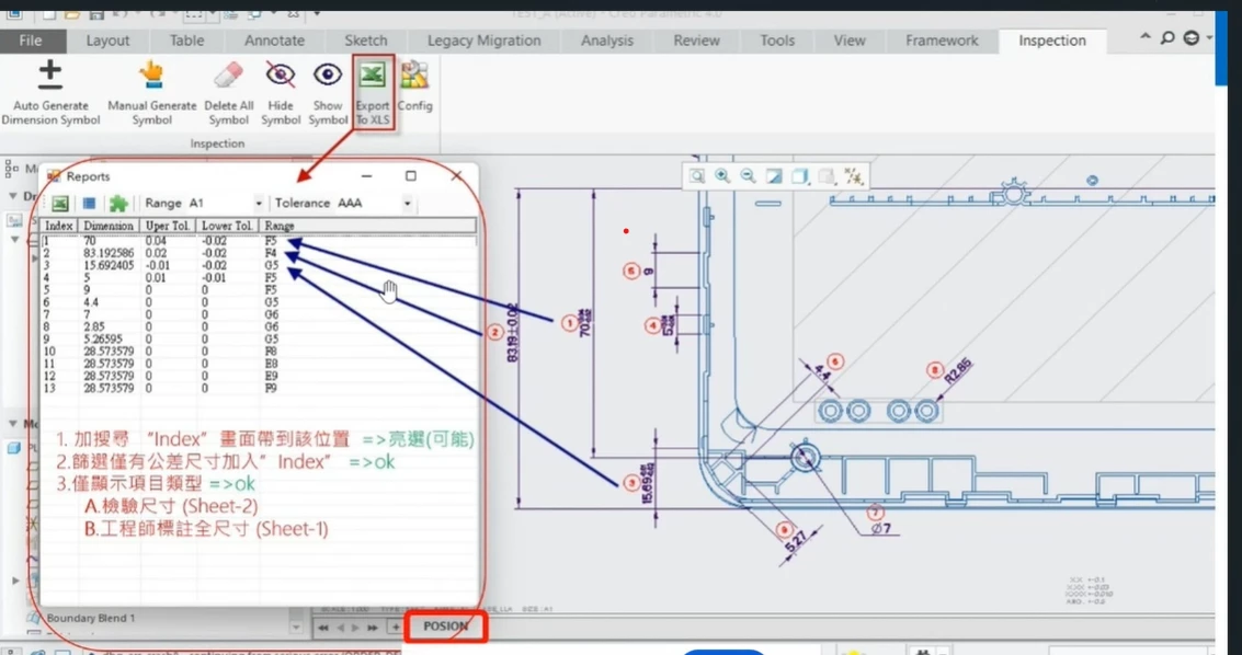

Dear Sirs,
I hope this message finds you well.
I am reaching out regarding the Creo drawing inspection function shown in the attached image. This function automatically generates a dimension report and allows for the export of dimension data to an Excel file via the "Export to XLS" button.
I am looking to automate this process using Creo TOOLKIT, specifically to automatically extract dimensions and generate the report. However, I am not very experienced with programming.
I would greatly appreciate any guidance, tips, or code examples on how to achieve this. Thank you in advance for your assistance!
