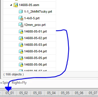

Does anyone have any tips on establishing a drawing template configured to automatically create drawing sheets based on the assembly and part names? I have an assembly structure on Windchill that i want replicated in the form of individual drawing sheets in one drawing, and preferably have the corresponding active model set and maybe a top view in the center.
I am unfamiliar with any methods besides mapkeys (which I have not been able to achieve my goal with), my main software of expertise is NX, which mainly utilizes Excel sheets and even a VBA macro recorder for automating tasks.
Any ideas or help with my challenge would be greatly appreciated, thank you.
