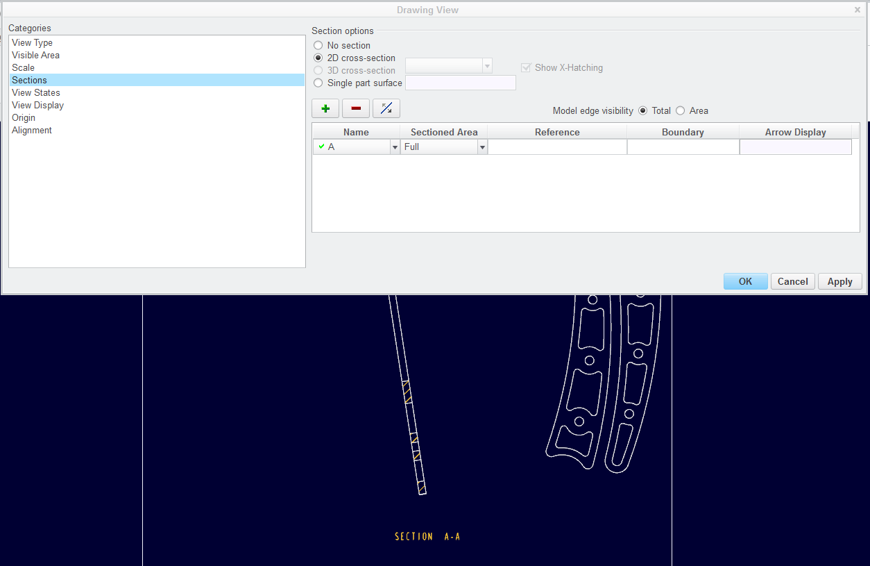

I do not know much about modelcheck but the section arrows are optional in later versions of WF and Creo. You can check to see if the arrows exist by looking at the view properties of the child view.

A way of doing it is to create a temporary (i.e. delete it when you have finished) Drawing Simplified Rep,
Tools > Drawing Representation > Create > Delete the standard Display all views command > add 1st command Erase All Views, 2nd comand Show Views of Type > X-Section.
You now have a drawing with only section views showing.
Select Insert > Arrows and click on each view that you can see, if there are arrows associated it says "No more arrows can be added for this view" if you do not get that message then there aren’t arrows!
Middle button if you don’t want them adding, or add them.
It is a bit of a lot of a work around but simplifies things a little (depending on how many cross section views you have, it might not help atall).
