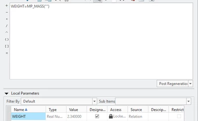

We use a relation to set the parameter weight = pro_mp_mass in our parts and then have weight designated in the start parts.
We also use a mapkey to recalculate the pro_mp_mass and then a regen to get it up date the weight parameter.
The key to getting the mapkey to update the designation check is to run it in the old UI. This will not toggle it.
Sep 17, 2020 2:21 PM UTC
We do the same thing. Our start parts have a parameter called "WEIGHT" and we use relations to set it equal to mass. Weight is a designated parameter so there is no need to toggle designation.
WEIGHT=MP_MASS("")

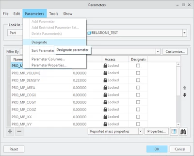

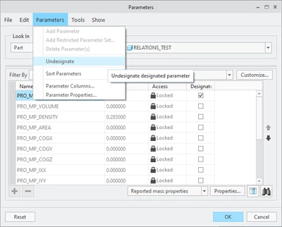

Sep 18, 2020 3:16 PM UTC
If you use the parameters menu (or right mouse button), designate and undesignate are both unique commands:
The same is true in the mapkey syntax:
mapkey(continued) ~ Activate `relation_dlg` `PBDesignate`;\
mapkey(continued) ~ Activate `relation_dlg` `PBUndesignate`;\
This means that it is possible to create a mapkey to designate a parameter with no risk that it will undesignate it if already designated.
mapkey tom @MAPKEY_NAMEtom;@MAPKEY_LABELtom;~ Command `ProCmdMmParams` ;\
mapkey(continued) ~ Select `relation_dlg` `ParamsPHLay.OMPrmType` 1 `reported_mp`;\
mapkey(continued) ~ Select `relation_dlg` `ParamsPHLay.ParTable` 2 `rowPRO_MP_MASS` `name`;\
mapkey(continued) ~ Activate `relation_dlg` `PB_OK`;
All testing was performed with Creo Parametric 6.0.5.1
