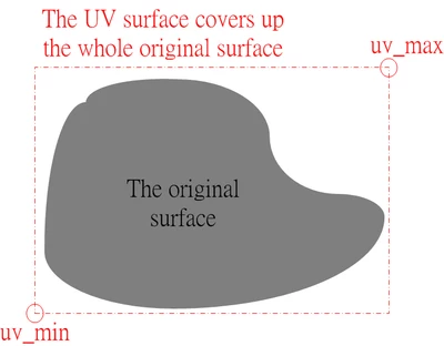

I got a question about outputs I got from ProSurfaceDataGet.
I  have uv_max & uv_min from surface data, which are values referring to UV coordinate, I know UV is a surface created to cover the whole surface, but I don't know if it is a plane or quilt, if it is a rectangle or in other shape.
I need to write essay, and this is part of it, thus I have to fathom it clearly and precisely.
Do you guys have any ideas about this ?
I put what I perceived below, I don't know whether it is right, pls correct me if I'm wrong.
BIG THANKS !

Hi
ProSurfaceDataGet is the API which gives you structure ProGeomitemdata as output.
ProGeomitemdata* p_data_ptr;
p_data_ptr->data.p_surface_data->srf_shape;
p_data_ptr->data.p_surface_data->type;
Above two information from geomitemdata structure might be helpful to you.
HIH
Ketan

*p_surf_type will tell you the Type, contour parsing may your next job 🙂
