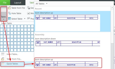

I am able to reproduce the problem with quick table named bom description up inside empty drawing (i.e. template drawing).
The problem can be also reproduced with manually created table containing 2 lines. I created the same table as bom description up.
The problem can be reproduced when the drawing does not have a model assigned.
Workaround:
  • create new drawing
  • assign a model to the drawing
  • place quick table named bom description up into the drawing
  • modify table properties as needed
  • save table into .tbl file
  • open drawing template
  • import .tbl file into drawing template
  • save drawing template
  • verify whether drawing template works well
