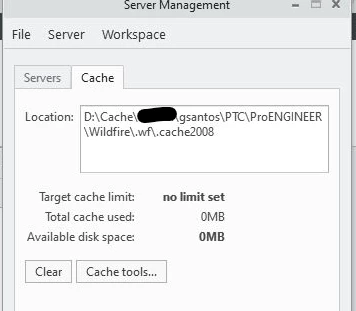

I work with 3 different clients all using the same version of CREO would there be any way when opening CREO select client and save the cache in a specific folder? today I use this way.
ENV=PTC_WF_ROOT=D:\Cache\%USERNAME%\PTC\ProENGINEER\Wildfire\.wf

in Parametric\bin directory you have to create three .psf files by copying parametric.psf file.
client1.psf
ENV=PTC_WF_ROOT=D:\Cache\%USERNAME%\PTC_WFROOT_Client1
client2.psf
ENV=PTC_WF_ROOT=D:\Cache\%USERNAME%\PTC_WFROOT_Client2
client3.psf
ENV=PTC_WF_ROOT=D:\Cache\%USERNAME%\PTC_WFROOT_Client3
