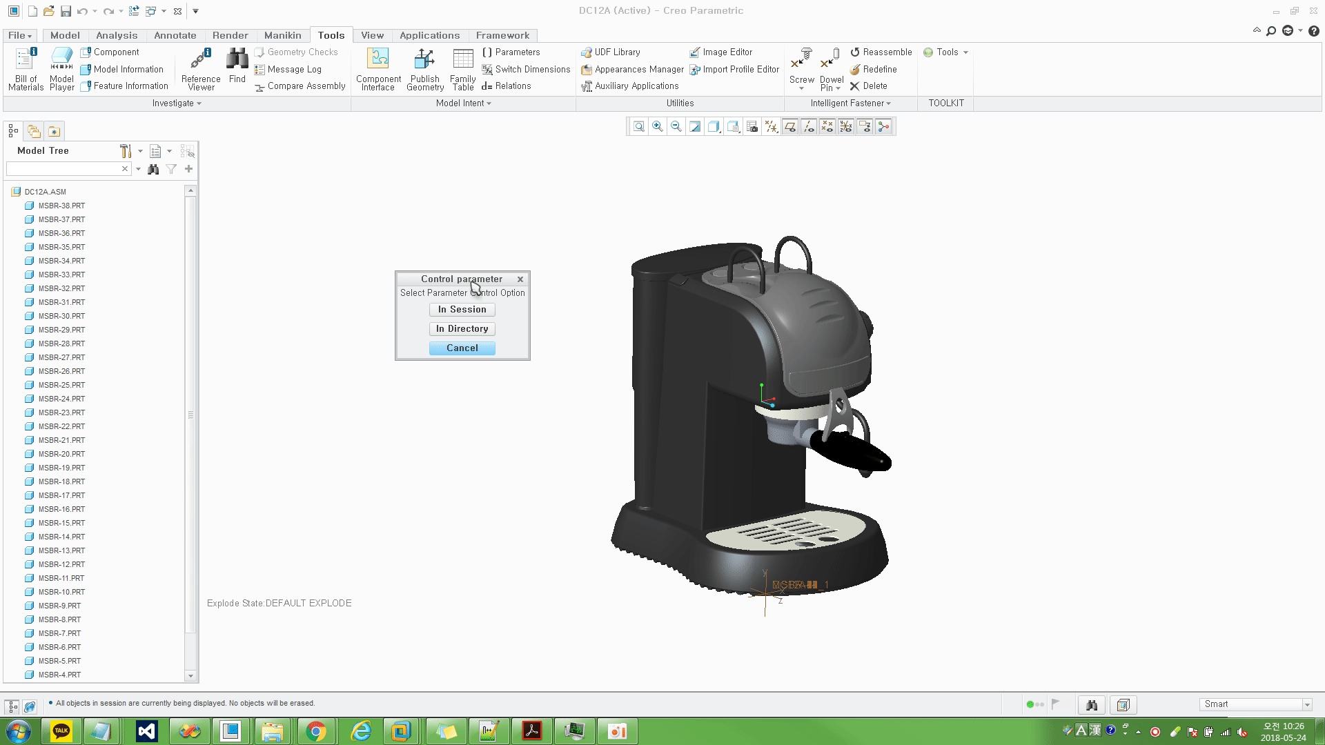

Can't select model with proUIDialog
Calling the function through ProUIPushbuttonActivateActionSet() causes a problem.
ProSelect()proselect.gif does not work!
What should I do?

May 24, 2018 4:11 AM UTC
Change DialogStyle value to 0
