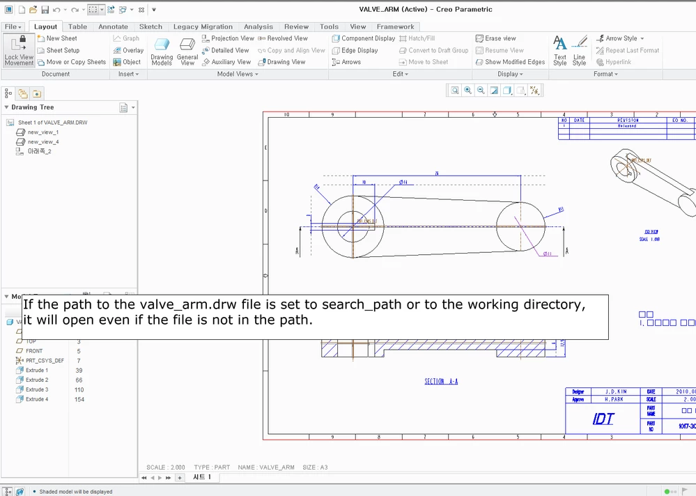

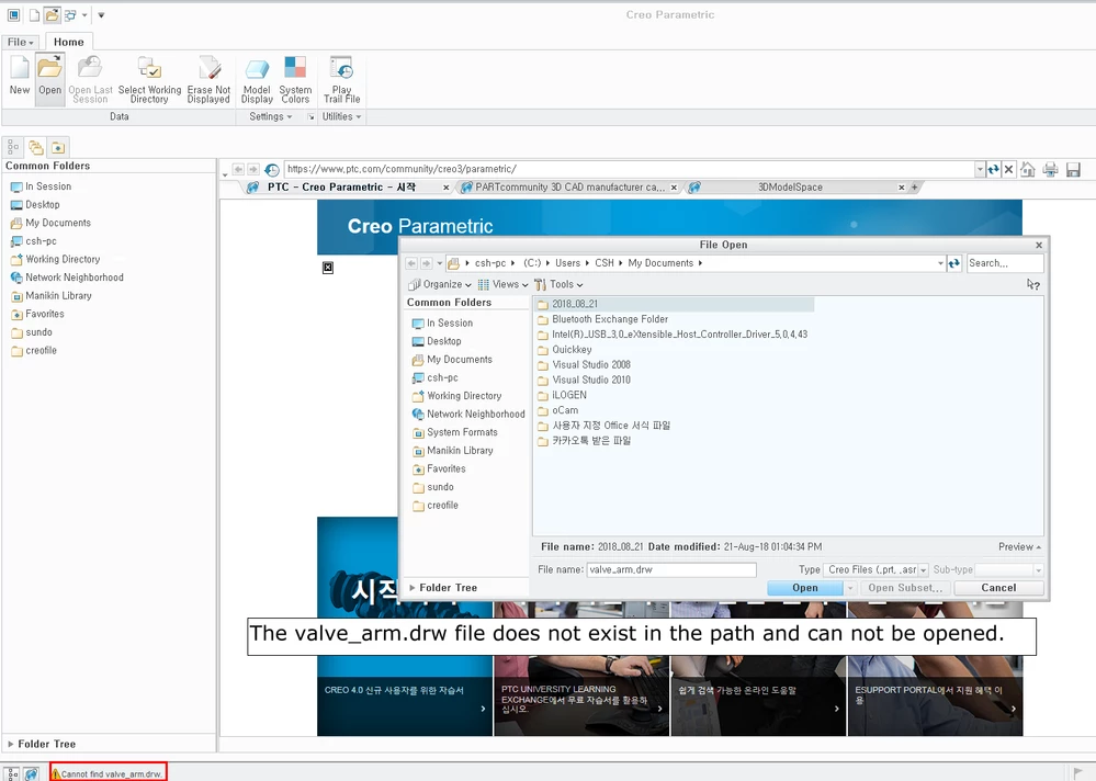

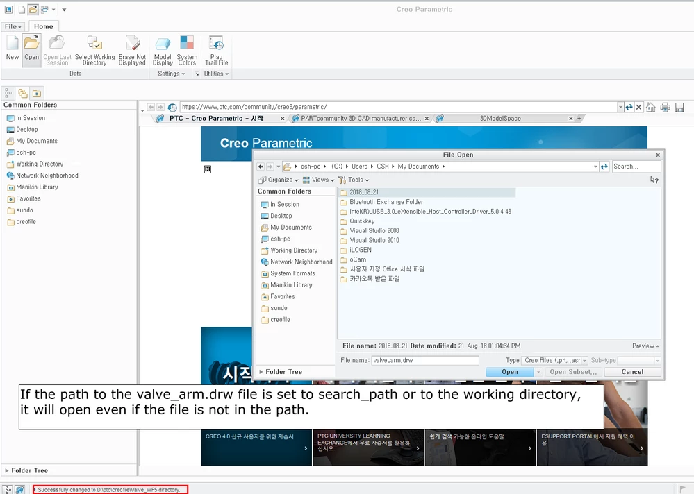

If you try to open a file from Creo, the file for the search path and the work path opens without specifying the location of the file.
Examples of photos
The toolkit requires a path to the file when using ProMdlLoad.
Can the toolkit read a file into a session without specifying a path, such as opening a file in Creo?
This should work in the background.

Try using ProMdlnameRetrieve.
ProMdlnameRetrieve loads the model in PDM space, working directory, search path order.
If you want to load the model only in Search Path, use ProConfigoptGet to get all lines of search_path.
Then use ProMdlLoad after all the search_path lines are followed by the name of the model.
