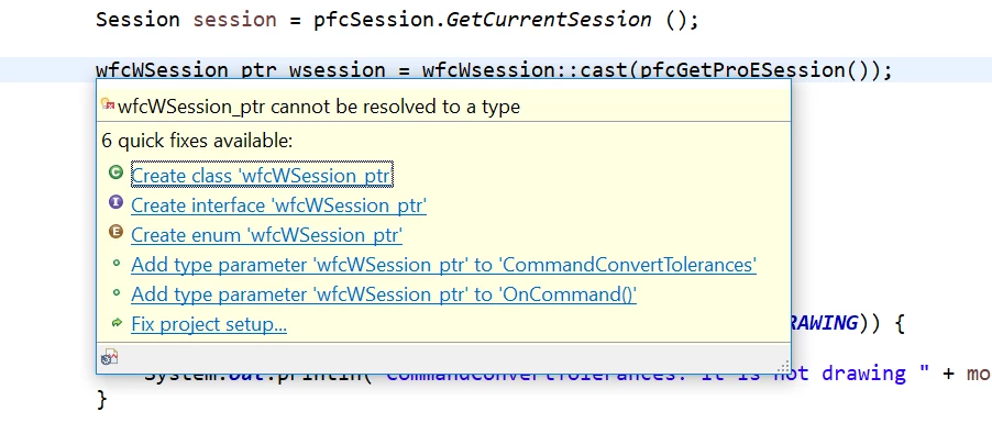

April 21, 2020
WSession.PNGHow i can access this Type (Pointer description)
Thank you very much!
April 21, 2020
Oh I'm sorry haven't done it in Java right now.
AFAIK it should be in the licensed OJava path. So you should need a Java OTK License for this (but I could be wrong / not sure about this ...).
Br,
Eike
