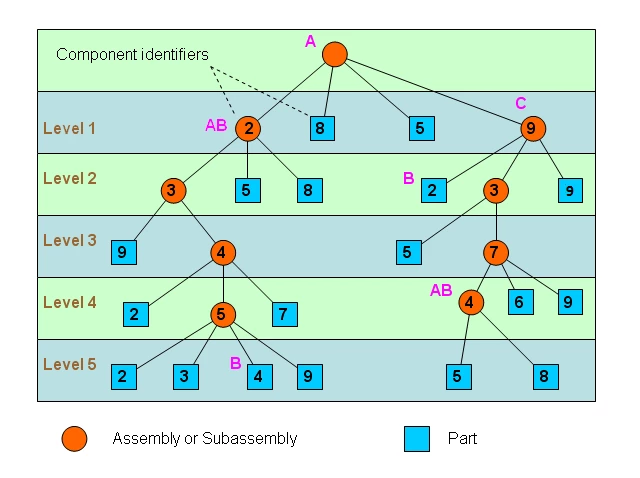

You can't cast, would not make sense. If you have a select structure, extract the path from here and use
 tk_status = ProAsmcomppathTrfGet (
   &pathPtr,
   bottom_up,
   matrixPtr);
If not, you have to search it, and init a component path, this may fun if the component is assembled more then once.
In the sample assembly hierarchy, subassembly C is component identifier 9 within assembly A, Part B is component identifier 2 within assembly C, and so on. The subassembly AB occurs twice (contain same ID's). To refer to the two occurrences of part B, use the following int array:
9, 2 or/or 2, 3, 4, 5, 4
Good luck 🙂
