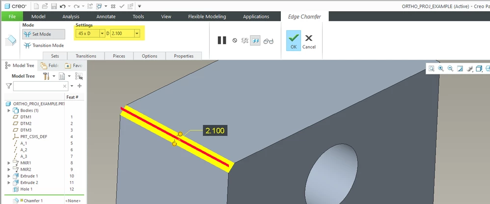

I have created a chamfer on a part using the chamfer tool but when I show model annotations in the drawing the callout is simply "C .250". I would like it to show as "45° X .250". How do I make it show that way?

In the chamfer creation UI what option did you use to create the chamfer? See example below for the option to define the angle and a linear dimension.
November 13, 2023
in Drawing mode look at detail option default_chamfer_text
You can find its description on following page
https://support.ptc.com/help/creo/creo_pma/r10.0/usascii/#page/detail/detail_options.html
