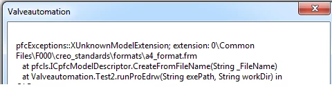

Hi Guys,
I need to change Drawing Sheet format Using VB.NET, I tried with below coding and I am getting error while "fdescr = (New CCpfcModelDescriptor)."
Please help to solve.

Error:
Please find attached file for error report
Could you Please confirm whether my code is correct or wrong when i try to retrievemodel
if it is possible to update current drawing sheet width and height, its very useful.

Hi Balaji,
according to the documentation, CreateFromFileName expects the name in this form:
The file name, of the form "<name>.<extension>"
Try to set the working directory to the required path or set search_path to that directory and call CreateFromFileName("a4_format.frm")

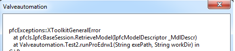

after updation new error occurred while run the code at line of
fmt = session.RetrieveModel(fdescr)
Error Image:
I think i have some problem in retrieve process. Please help.
