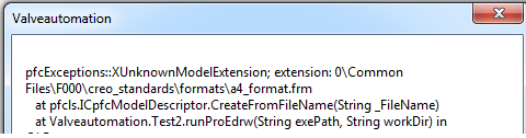

I have attached my coding for your reference, as per your instruction i mention the frm file path and tried but i am getting below error while assign the  "fdescr = (New CCpfcModelDescriptor)."
Please help me to solve.

Jan 3, 2017 12:34 PM UTC
According to VB API documentation the file name should be of the form "<name>.<extension>".
The problem is probably that you have full path.
