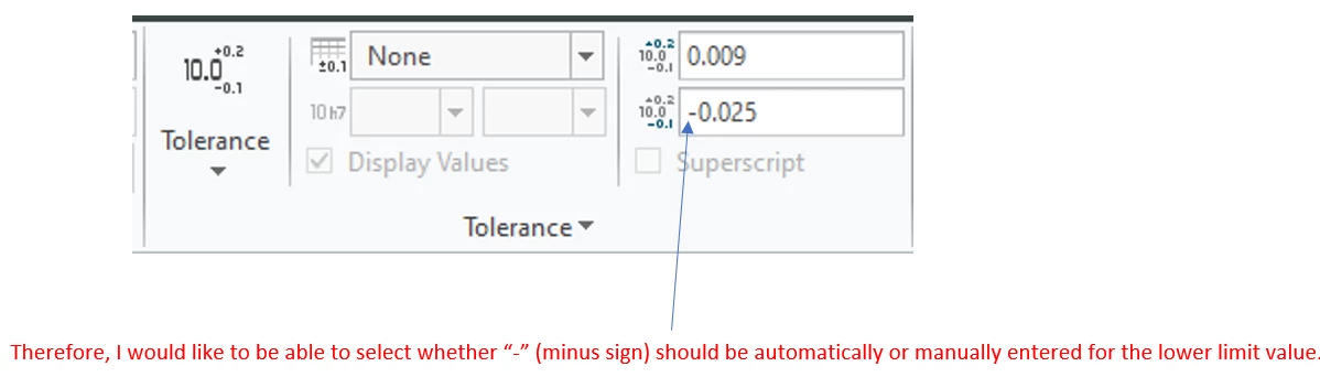

Change of setting for automatic entry of the lower tolerance limit of tolerance “plus - minus”.
Softwear: Creo Parametric
Release: 7.0
Version: 7.0.8.0
Dimension ⇒ Tolerance “Plus - Minus” ⇒ Selecting None will automatically enter “-” for the lower limit.

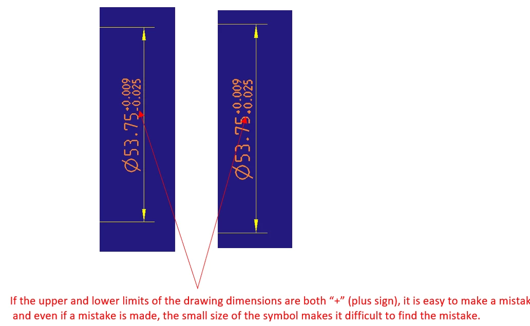

If the upper and lower limits of the drawing dimensions are both “+” (plus sign),
it is easy to make a mistake, and even if a mistake is made, the small size of the symbol makes it difficult to find the mistake.
It is not possible to set the Pro/TOOLKIT module to not enter “-” in the lower limit tolerance field by default, even in the Pro/TOOLKIT module.
Therefore, I would like to be able to select whether “-” (minus sign) should be automatically or manually entered for the lower limit value.
