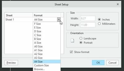

Change standard frames in the Frame template drop down menu
Hi, I want to change the standard frames which are shown in the sheet setup/format.
I know I can load my own frames but I would like to have them shown in the drop down menu.
Where can I change that setting?

I think it is not possible. You can create a set of mapkeys that perform the required functionality.

You can add your new frames all to 1 folder, then set the config option pro_format_dir to that folder. With that, you can get to all your frames after clicking "browse".
Nov 28, 2022 5:25 PM UTC
We have been using the config option pro_format_dir and select Browse for many years, but I would like to see them listed in the dropdown for easier selection.
