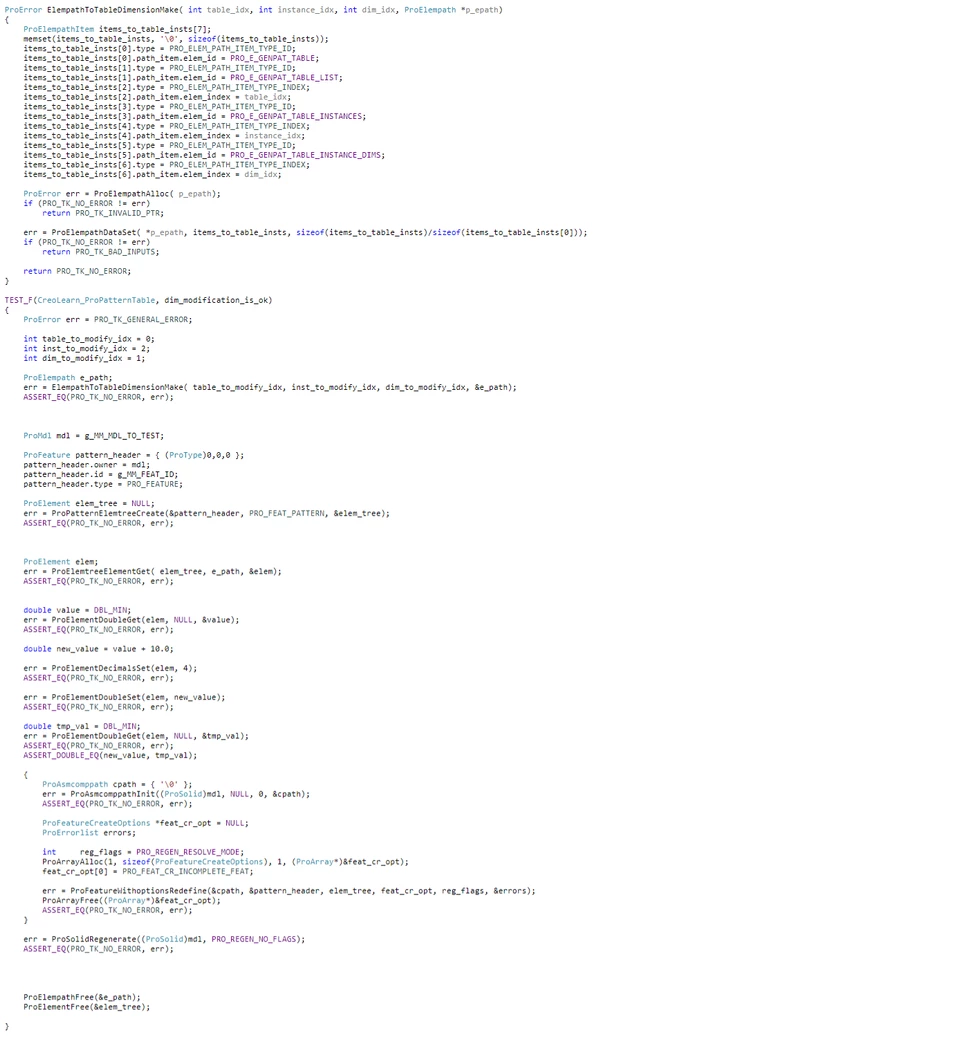

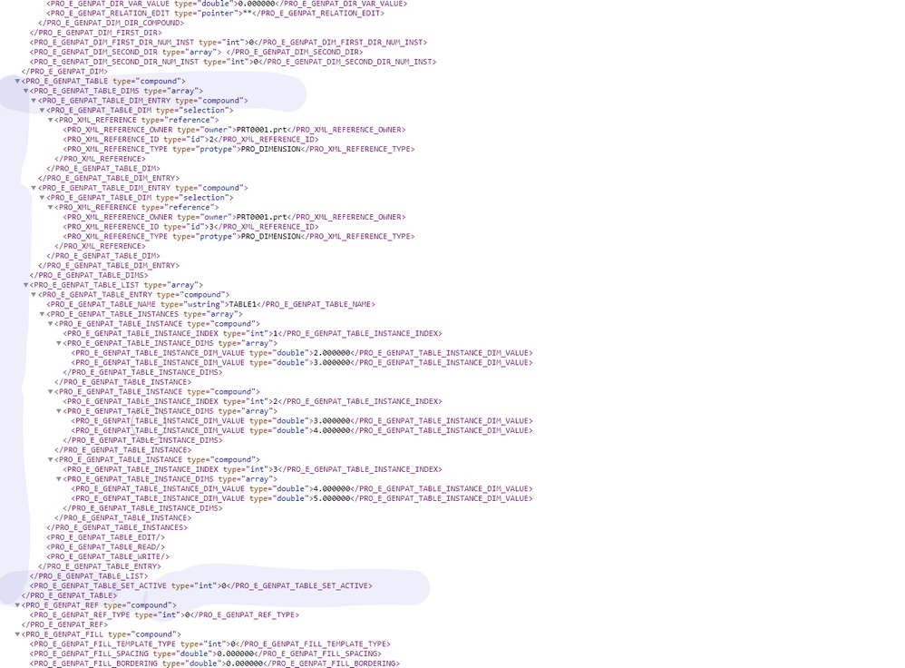

FV_01Answer
Aug 13, 2019 7:59 PM UTC
modification of the element tree for table driven patterns should work just fine...
here is the sample of the feature tree:2_.png
here is the code:
11 replies

Note: ProPattern.h will contain all you need to deal with that kind of a feature, in my point of view Dave is wrongSmiley LOL
| * Table Pattern *
|--- PRO_E_GENPAT_TABLE
| |--- PRO_E_GENPAT_TABLE_DIMS
| | |--- PRO_E_GENPAT_TABLE_DIM_ENTRY
| |--- PRO_E_GENPAT_TABLE_LIST
| | |--- PRO_E_GENPAT_TABLE_ENTRY
| | |- PRO_E_GENPAT_TABLE_NAME
| | |--PRO_E_GENPAT_TABLE_INSTANCES
| | |--PRO_E_GENPAT_TABLE_INSTANCE_INDEX
| | |--PRO_E_GENPAT_TABLE_INSTANCE_DIMS
| | |--PRO_E_GENPAT_TABLE_INSTANCE_DIM_VALUE
| |--- PRO_E_GENPAT_TABLE_SET_ACTIVE
Here is all you need for a Table Pattern. But I think, you don't need that.

18-Opal
Aug 12, 2019 4:27 PM UTC
If the model has an error after Regen, the new values may ignored, check your config. As far I know, you have to parse an input file by yourself, a function for input is not available.
Regarding the feature tree, for me ProFeatureElemDimensionIdGet() will return NOT_FOUND (-4) but
.7 -type DPOINT_OFST_CSYS_PNTS_ARRAY -array
.7.1 -type DPOINT_OFST_CSYS_PNT -compound .7.1.1 -type DPOINT_OFST_CSYS_PNT_NAME -wstring PNT0 .7.1.2 -type DPOINT_OFST_CSYS_DIR1_VAL -double 10.0 .7.1.3 -type DPOINT_OFST_CSYS_DIR2_VAL -double 20.0 .7.1.4 -type DPOINT_OFST_CSYS_DIR3_VAL -double 30.0 .7.2 -type DPOINT_OFST_CSYS_PNT -compound .7.2.1 -type DPOINT_OFST_CSYS_PNT_NAME -wstring PNT1 .7.2.2 -type DPOINT_OFST_CSYS_DIR1_VAL -double 40.0 .7.2.3 -type DPOINT_OFST_CSYS_DIR2_VAL -double 50.0 .7.2.4 -type DPOINT_OFST_CSYS_DIR3_VAL -double 60.0 ...
 you can walk the tree, change the double values, and redefine the feature at the end.
RPN

For the tree, here the part of the tree for 2 tables and the second one is active with 3 points
.3.2 -type GENPAT_TABLE_LIST -array
.3.2.1 -type GENPAT_TABLE_ENTRY -compound
.3.2.1.1 -type GENPAT_TABLE_NAME -wstring TABLE1
.3.2.1.2 -type GENPAT_TABLE_INSTANCES -array
.3.2.1.2.1 -type GENPAT_TABLE_INSTANCE -compound
.3.2.1.2.1.1 -type GENPAT_TABLE_INSTANCE_INDEX -integer 1
.3.2.1.2.1.2 -type GENPAT_TABLE_INSTANCE_DIMS -array
.3.2.1.2.1.2.1 -type GENPAT_TABLE_INSTANCE_DIM_VALUE -double 11.0
.3.2.1.2.1.2.2 -type GENPAT_TABLE_INSTANCE_DIM_VALUE -double 31.0
.3.2.1.2.1.2.3 -type GENPAT_TABLE_INSTANCE_DIM_VALUE -double 21.0
.3.2.1.2.2 -type GENPAT_TABLE_INSTANCE -compound
.3.2.1.2.2.1 -type GENPAT_TABLE_INSTANCE_INDEX -integer 2
.3.2.1.2.2.2 -type GENPAT_TABLE_INSTANCE_DIMS -array
.3.2.1.2.2.2.1 -type GENPAT_TABLE_INSTANCE_DIM_VALUE -double 111.0
.3.2.1.2.2.2.2 -type GENPAT_TABLE_INSTANCE_DIM_VALUE -double 131.0
.3.2.1.2.2.2.3 -type GENPAT_TABLE_INSTANCE_DIM_VALUE -double 121.0
.3.2.1.3 -type GENPAT_TABLE_EDIT
.3.2.1.4 -type GENPAT_TABLE_READ
.3.2.1.5 -type GENPAT_TABLE_WRITE
.3.2.2 -type GENPAT_TABLE_ENTRY -compound
.3.2.2.1 -type GENPAT_TABLE_NAME -wstring TABLE2
.3.2.2.2 -type GENPAT_TABLE_INSTANCES -array
.3.2.2.2.1 -type GENPAT_TABLE_INSTANCE -compound
.3.2.2.2.1.1 -type GENPAT_TABLE_INSTANCE_INDEX -integer 1
.3.2.2.2.1.2 -type GENPAT_TABLE_INSTANCE_DIMS -array
.3.2.2.2.1.2.1 -type GENPAT_TABLE_INSTANCE_DIM_VALUE -double 50.0
.3.2.2.2.1.2.2 -type GENPAT_TABLE_INSTANCE_DIM_VALUE -double 60.0
.3.2.2.2.1.2.3 -type GENPAT_TABLE_INSTANCE_DIM_VALUE -double 70.0
.3.2.2.2.2 -type GENPAT_TABLE_INSTANCE -compound
.3.2.2.2.2.1 -type GENPAT_TABLE_INSTANCE_INDEX -integer 2
.3.2.2.2.2.2 -type GENPAT_TABLE_INSTANCE_DIMS -array
.3.2.2.2.2.2.1 -type GENPAT_TABLE_INSTANCE_DIM_VALUE -double 55.0
.3.2.2.2.2.2.2 -type GENPAT_TABLE_INSTANCE_DIM_VALUE -double 65.0
.3.2.2.2.2.2.3 -type GENPAT_TABLE_INSTANCE_DIM_VALUE -double 75.0
.3.2.2.2.3 -type GENPAT_TABLE_INSTANCE -compound
.3.2.2.2.3.1 -type GENPAT_TABLE_INSTANCE_INDEX -integer 3
.3.2.2.2.3.2 -type GENPAT_TABLE_INSTANCE_DIMS -array
.3.2.2.2.3.2.1 -type GENPAT_TABLE_INSTANCE_DIM_VALUE -double 70.0
.3.2.2.2.3.2.2 -type GENPAT_TABLE_INSTANCE_DIM_VALUE -double 80.0
.3.2.2.2.3.2.3 -type GENPAT_TABLE_INSTANCE_DIM_VALUE -double 90.0
.3.2.2.3 -type GENPAT_TABLE_EDIT
.3.2.2.4 -type GENPAT_TABLE_READ
.3.2.2.5 -type GENPAT_TABLE_WRITE
.3.3 -type GENPAT_TABLE_SET_ACTIVE -integer 1
Here I would be able to modify the value. I need to have the tree for the pattern feature with the id 334. To change the last dim (90.0) within the tree:
ps_ftree ft
ft config -model $M -id 334 -type pattern
ft get
ft itemconfig .3.2.2.2.3.2.3 -double 99.99
ft redefine
