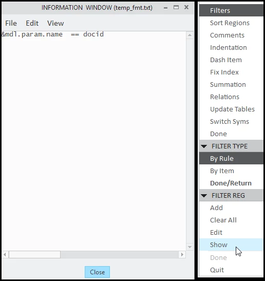

so I already have a toolkit that iterate trough a drawing tables and check for table with repeat region.
What I would like to do is that while going through the tables, find the one that has a certain filter.
When in CREO I go to the Repeat Region Menu then select Filter and Show, I can see this as my filter: &mdl.param.name == docid
The table is always a single cell table containing my document number and would like to get it.
Anyone knows how to achieve this?

But this only returns this:
Best answer by AlexCote
I finally ask PTC about this, and they have confirm me that this is not supported by the Toolkit API.
AlexCote1-VisitorAuthorAnswer
July 12, 2019
