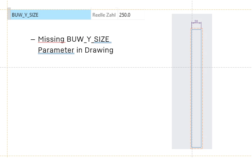

June 4, 2025
Hello @SamuelBrantner ,
i want to create automatically a drawing like that for example.
I created a drawing from a profile like the default AFX profile structure but actually it doesnt even create a drawing from my profiles.
SamuelBrantner
June 4, 2025
Hi @OS_11014878 ,
is there already a drawing existing? AFX will only try to create a drawing if no drawing is existing.
Greetings Sam
