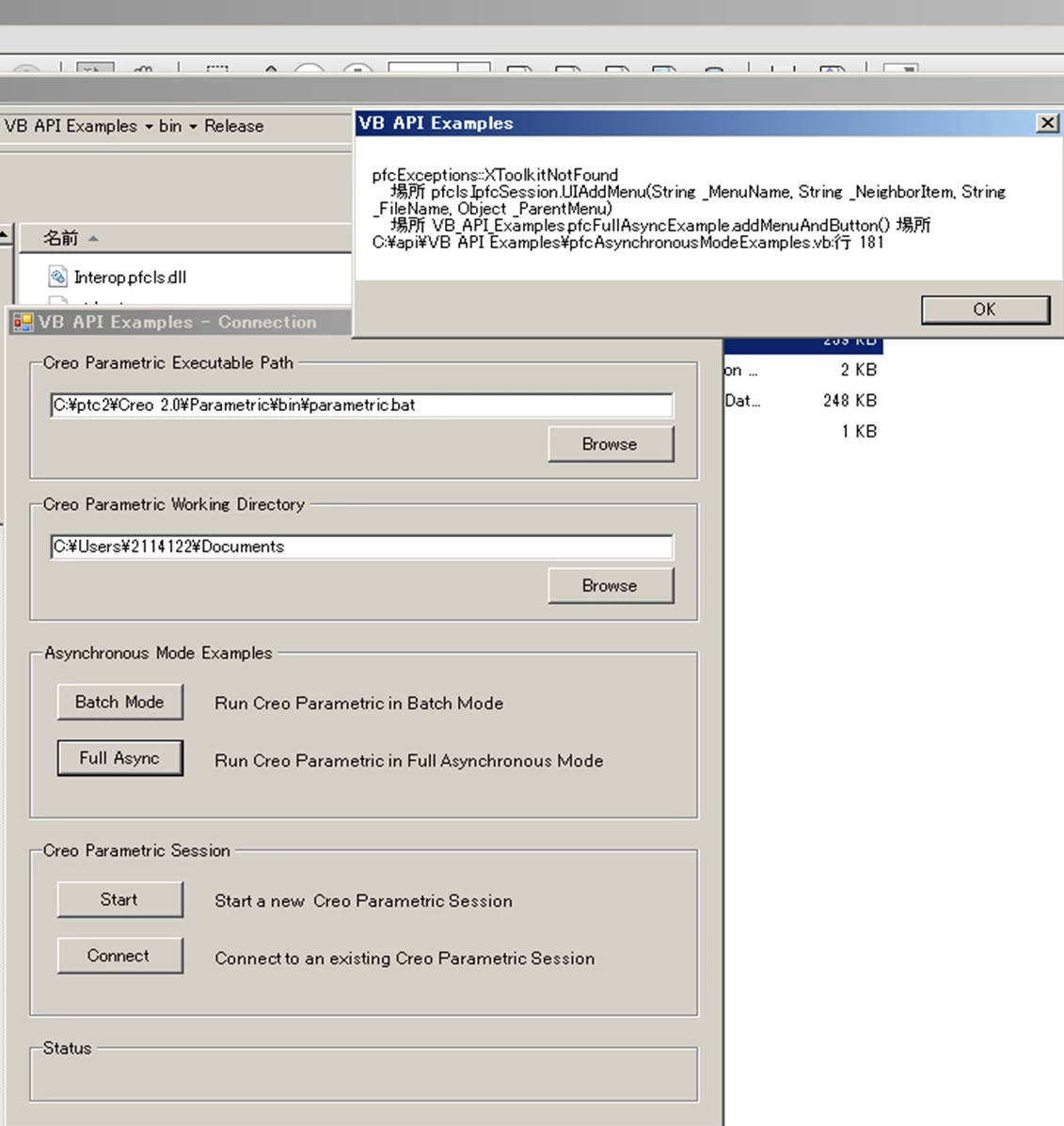

I am planning to use the CREO VB API to make an application that runs in full asynchronous mode.
as a first step I compiled the examples provided in the vb API folder (VB API Examples) with Visual Studio Community and ran them.
the Simple Asynchronous mode connects and  run perfectly. However, when i try to connect in Full Asynchronous, CREO starts and I get the error message shown in the attached file. After clicking OK in the error window, the "VB API Examples" Form is not loaded as expected and the connection form which is still visible becomes unresponsive. I have to shut-down CREO to get the connection form back.
Do we need an additional license to run in Full Asynchronous with the VB API, or is it just the result of a wrong command in the VB.net program? or maybe my settings? I am using CREO 2.0 M100

hello,
According to the error message, the error comes from the following portion of code below.
The text in bold is the one you're looking for, but I don't get why it's not working.....Someone Help!!!:
    'Function   :   addMenuAndButton
    'Purpose    :   This function demonstrates the usage of UI functions to
    '               add a new menu and button to Creo Parametric.
    Private Sub addMenuAndButton()
        Dim session As pfcls.IpfcSession
        Dim inputCommand As IpfcUICommand
        Dim buttonListener As IpfcUICommandActionListener
        Dim exitCommand As IpfcUICommand
        Dim eListener As IpfcUICommandActionListener
        Try
            session = asyncConnection.Session
            buttonListener = New ButtonListener()
            eListener = New ExitListener()
            'Command is created which will be associated with the button. The class
            'implementing the actionlistener must be given as input.
            inputCommand = session.UICreateCommand("INPUT", buttonListener)
            exitCommand = session.UICreateCommand("EXIT", eListener)
            'Menu is created and buttons are created in the menu
            session.UIAddMenu("VB-Async", "Windows", "pfcAsynchronousModeExamples.txt", Nothing)
            session.UIAddButton(exitCommand, "VB-Async", Nothing, _
                                "USER Exit Listener", "USER Exit Help", "pfcAsynchronousModeExamples.txt")
            session.UIAddButton(inputCommand, "VB-Async", Nothing, _
                                "USER Async App", "USER Async Help", "pfcAsynchronousModeExamples.txt")
        Catch ex As Exception
            MsgBox(ex.Message.ToString + Chr(13) + ex.StackTrace.ToString)
        End Try
    End Sub
