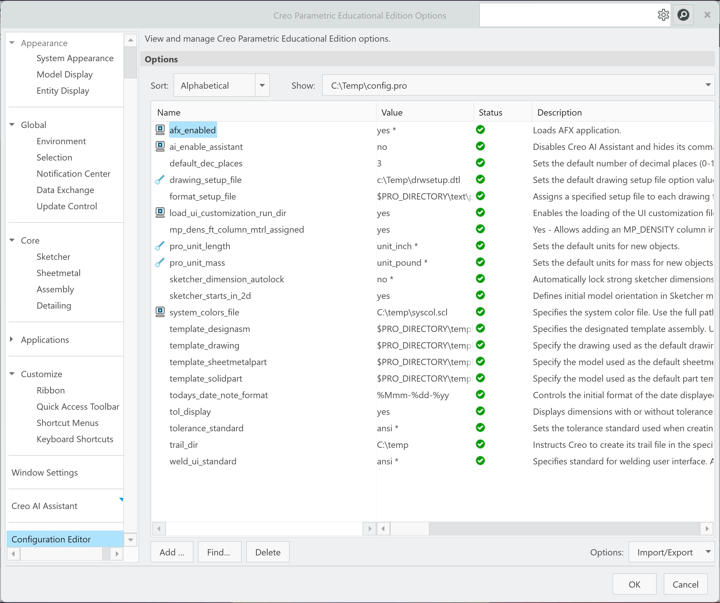

I really appreciate the advice Ken, so thanks for weighing in again. Unfortunately I still haven’t gotten it working as the tolerances are still greyed out.
I created a second file “drwsetup.dtl” in my startup folder and threw in “tol_display yes”. In addition to that, I added “drawing_setup_file c:\temp\drwsetup.dtl” into the config.pro files in the startup folder (called “temp”) and again into the original location (C:\Program Files\PTC\Creo 13.4.0.0\Common Files\text).

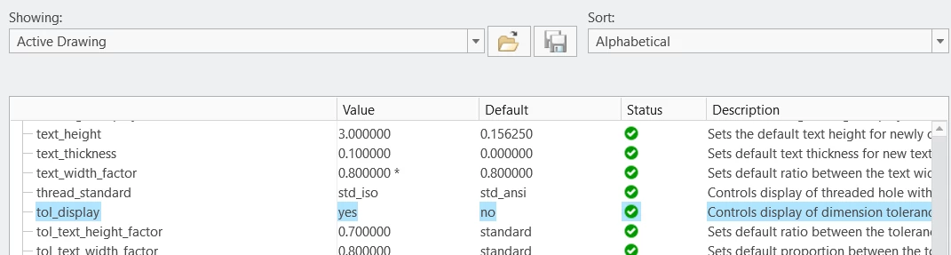

If you look at the loaded config.pro do you see this.
and

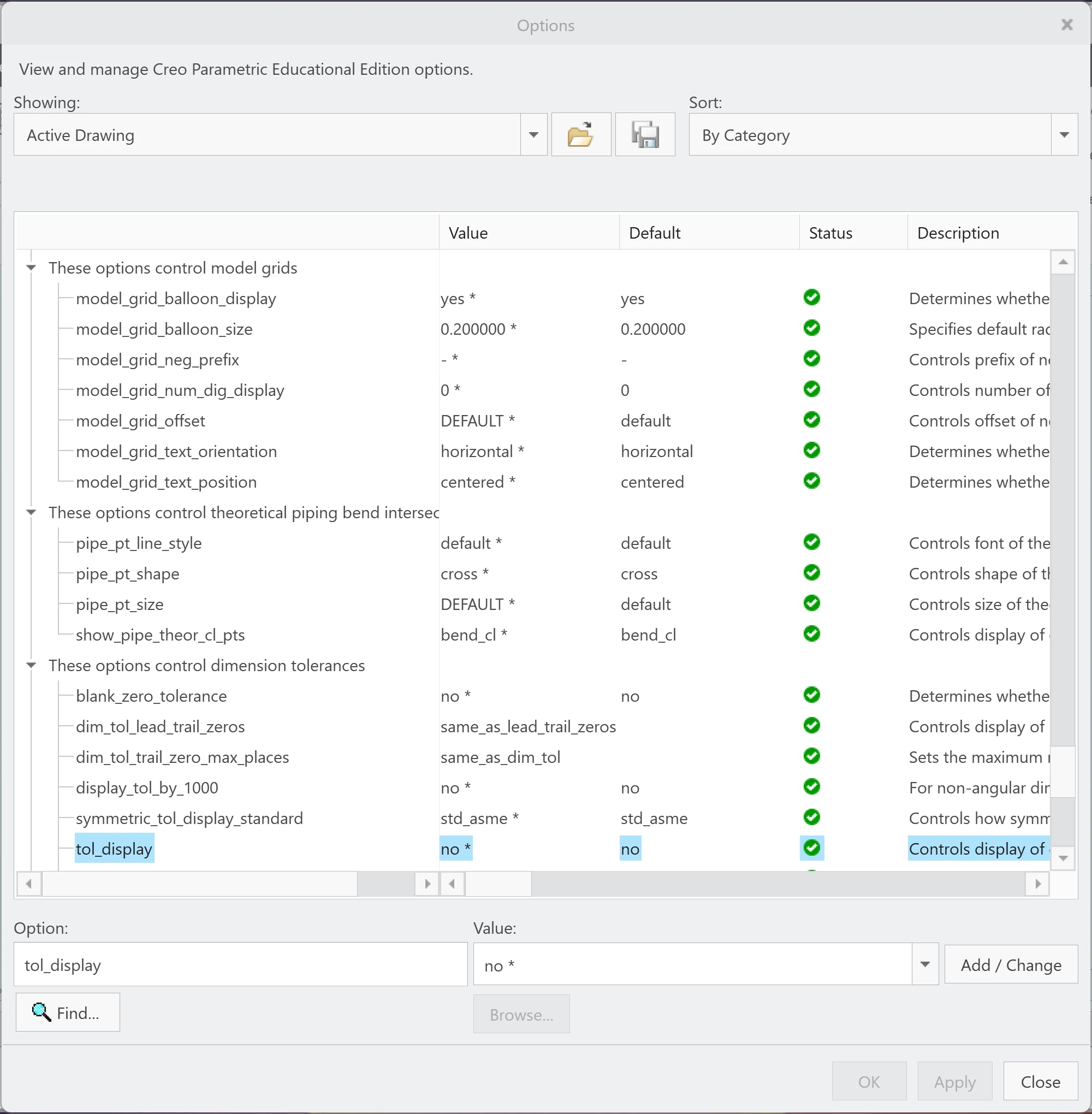

if you look at the drawing setup of the active drawing do you see this
The DTL file is copied into the drawing on creation and is not updated after that.

Hi Bryan!
Regarding picture 1, upon opening the config file I do see tol_display is set to yes.
RE picture 2, underneath Active Drawing, it’s set to no by default. I have to change that every time I make a new drawing.
MikeBennett
Jul 21, 2026 12:46 PM UTC
Hi ​@A_Gaillard,
I think you’re missing one last step from all the previous assistance.
the config.pro tol_display is for 3d models.
the detail option tol_display is for 2d drawings.
If you set tol_display in the .dtl file defined by config.pro drawing_setup_file, this will apply to new, empty drawings.
Changing .dtl options will not retroactively apply to existing drawings as the .dtl options are applied at drawing creation.  You can manually update existing drawings or reapply .dtl files through File > Prepare > Drawing Properties > Detail Options change > open a configuration file.  If you have multiple drawings that need to be updated, you could set up a mapkey to help automate the repeated task.
If you use a template drawing for new drawings, the new drawing inherits the detail options from the template, not from drawing_setup_file.  This means to change the option for new drawings which use that template, you should open the template drawing and update the tol_display option then save the template.  New drawings from this template will use the updated value.
I hope this helps but let us know if there are any further requirements
Mike
