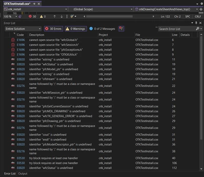

I'm experiencing significant issues connecting Creo Parametric with Visual Studio. Currently, I'm referring to the "Creo Object Toolkit C++ Release Notes" for guidance, but I'm encountering numerous errors. Could you provide a step-by-step guide on how to properly connect Creo and Visual Studio?

Those errors suggest that in your project properties you have not included the directories where those header files exist , e.g.:
The paths you would need to include are:
<Creo install loaction> \Common Files\otk\otk_cpp\include\
<Creo install loaction> \Common Files\otk\otk_cpp\otk_examples\includes\

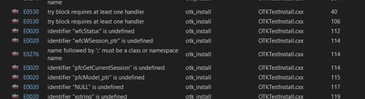

Like These types of errors i am getting,
