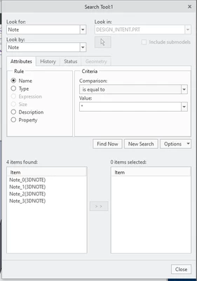

To count the number of notes, you could do the following
  • press <ctrl><f>
  • select "look for : note" (see screenshot below)

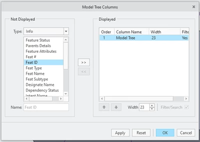

To see the id, you could add the id to a tree column
