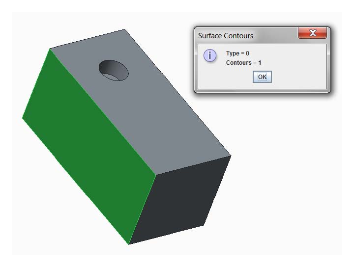

I need to know the numbers of perimeters of sheetmetal, because I use the value to calculate the LASER machine timing.
The image below shows an example.
As you can see, the red area is 1 (one) perimeter, and the yellow area is 1 (one) perimeter, totaling 2 (two) perimeters. The result that I’m looking for is the 2 (two).
I tried to use development tools like Jlink and Weblink, but didn’t find anything as expected.
Has anyone done something similar?
Thank you!

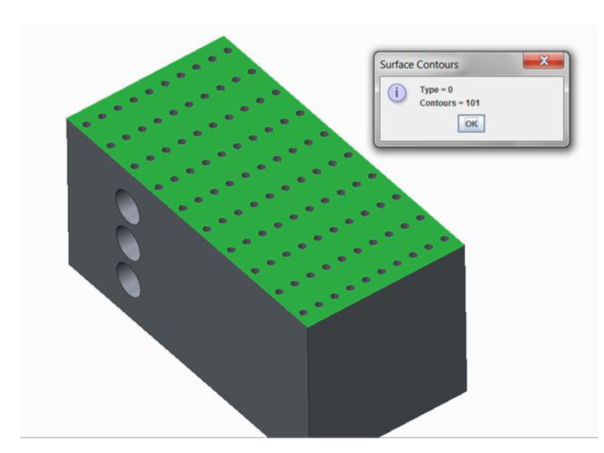

J-Link will get that for you. Those are Contours. You need to get the feature, get the surface, then get the contours.
Try This...It will let you interactively select a surface and outputs a message box with the Contour count.
It works on a standard part. Since I don't use sheetmetal parts very often we may need to tweek it a bit but I think it should work.

Contours contours = surf.ListContours();
//Output to message box or wherever you want the info
JOptionPane.showMessageDialog(null, "Type = " +sfType.getValue()+"\nContours = " +contours.getarraysize(),
"Surface Contours",JOptionPane.INFORMATION_MESSAGE);
