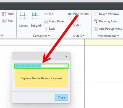

I see there is a Progress bar component in Creo UI editor.
1. Is it possible to have something like a progress circle in Creo UI editor?
2. Or a custom gif that we could display to accomplish showing an in-progress operation?

Looks like there is a progress bar component. I have never used it before. (The screen shot is from version 7)

Thanks @MikePhillips .
 Apologies if I was not clear, what I meant was, I see the Progress bar component but is it possible to use a circle to show the progress instead of a 'bar' or anything custom for that matter.

I would think you could utilize a Drawing Area. You could then loop thru a serious of images that create the illusion of an animated circle progress. Or draw a progress image.
