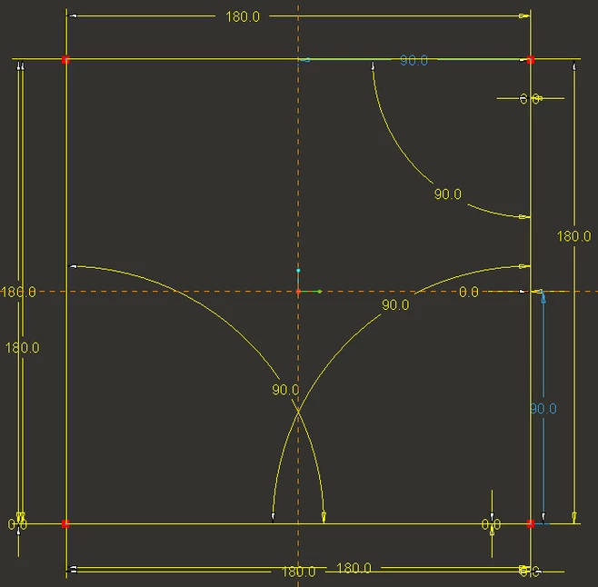

I am trying to create a rectangle of four lines using OTK Java. This will be a section for my extrusion. All lines for the extrusion must be coincident. But I don’t know how to make them like that.
Because of this, it is not possible to extrude.
My code is:
Point2Ds tops = Point2Ds.create();
Point2D A = wfcSession.CreatePoint2D(90.00,90.00);
Point2D B = wfcSession.CreatePoint2D(90.00,-90.00);
Point2D C = wfcSession.CreatePoint2D(-90.00,-90.00);
Point2D D = wfcSession.CreatePoint2D(-90.00,90.00);
Point2D E = wfcSession.CreatePoint2D(90.00,90.00);
tops.set(0, A); tops.set(1, B); tops.set(2, C); tops.set(3, D); tops.set(4, E);
SectionEntityPolyline rectangle = wfcSection.SectionEntityPolyline_Create(tops);
SectionEntity entity = (SectionEntity)rectangle;
sketch.AddEntity(entity);
Section that is obtained after starting:
Please help, if anyone knows.
Thanks in advance.

I believe that the trick is SetIntentManagerMode()
sketch.SetIntentManagerMode(true); // magic ON

sketch.SetIntentManagerMode(false); // magic OFF
VladiSlav17-PeridotAuthor
Dec 4, 2019 8:33 AM UTC
Thanks for the answer!
Yes, I understand that I need to enable ManagerMode.
I already did that and everything worked with the round section.
Now I want to create a part with a rectangular section, but I can’t draw such a section.
Best Regards!

 Try to use something like this
// ADD
