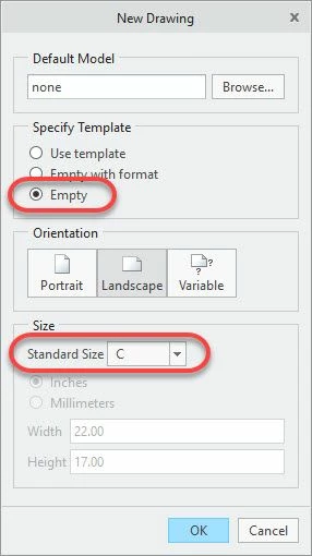

You can create a drawing template (.drw) with that doesn't have a format (.frm).
Steps:

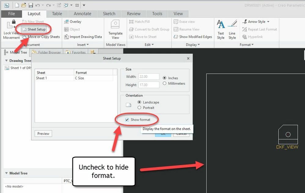

  • Create New Drawing and Specify Template as 'Empty'. Pick a size - I usually pick the default C but it doesn't really matter. Creo will show an outline of the size of the drawing unless you hide the 'format'.

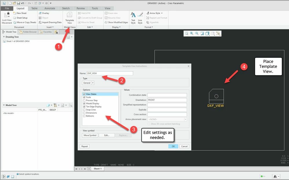

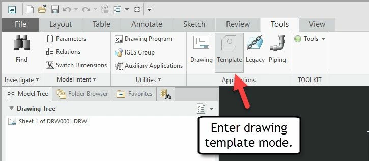

  • With the drawing created, you can then enter Drawing Template mode - Tools>Applications>Template. This allows you to create a VIEW TEMPLATE with the desired settings: Orientation (Front, Back, View4DXF, etc.), Scale = 1, Model Display, Tangent Edge Display settings, etc.
  • You can then use this as a drawing template (File>New>Drawing>From Template) that will place the DXF view automatically. You may have to reorient the view manually as needed and/or delete Scale=1 text.
