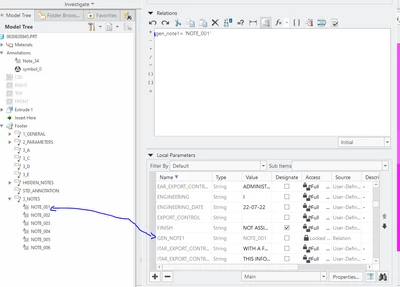

Hi i want to create a relation that creates a note parameter. like note A
 i can make number parameters, strings parameters,  etc. but not a note parameter (the current parameter is a string i want it to be a note parameter

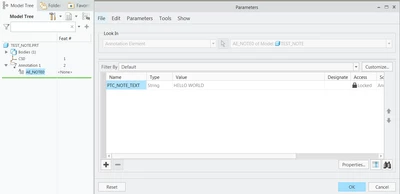

Yes, here is a sample drawing and model (Creo 7) that implements the scheme you describe above.
There is a parameter generated within a model note as seen here. That can be used in a relation.
Here are the model parameters used to generate the note seen in the drawing

You can use a parameter value within a note which is what I gather you are attempting. Once the value of Gen_Note1 is defined you can then use that value in a note by using the following syntax "&Gen_Note1" .
Keep in mind that if the string value of a parameter is lengthy then using it to generate a note is not the best way to handle this in Creo IMO.
One option is to define your standard notes in a text editor (i.e. MS Word) and include the parameter names for values that will vary when the note is placed into a model or drawing. This will make it easier to maintain the standard notes and enable re-use.

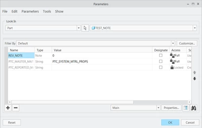

no I'm trying to create the parameter gen_note1 as a note parameter through a relation like parameter A here
tbraxton
Aug 3, 2022 4:53 PM UTC
I am still not clear one what you are attempting to do.
Your goal is to create a parameter "A" of type note by evaluating a relation in a part model?
