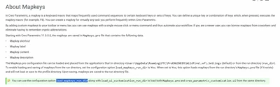

Creo is managed by our company with some standard settings. Every time we open Creo the config.pro and the mapkeys in the run directory are overwritten with our companies default settings. I have added in my user level config.pro and system colors, but am having trouble doing the same with the mapkeys.

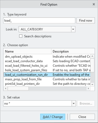

I followed the instruction in the support documentation, but when I click find in the config.pro and search for "load_mapkeys_run_dir" it doesn't exist so I cannot change the setting to pull from the designated location outside of the run directory.
Best answer by BenLoosli
You need a newer version of Creo:
Starting from Creo Parametric 11.0.5.0 and Creo Parametric 12.4.0.0, the mapkeys.pro configuration file can now be placed and loaded from the application's Start in directory.
new configuration option ... load_mapkeys_run_dir
Article - CS416002 - Is it possible to read Mapkeys.pro from Start-in directory since Creo Parametric 11.0
