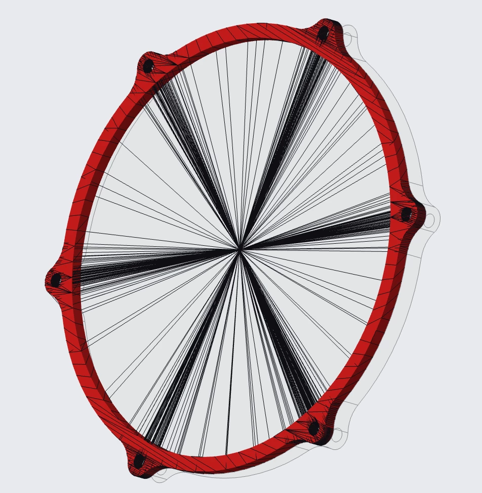

Hello everyone,
I am running Creo Parametric 11.0.5.0 Education on Windows 11 ARM inside Parallels Desktop 20.4 on an Apple Mac mini M4 Pro with 12 Cores and 24 GB of RAM for the Virtual Machine.
After adding the following lines at the beginning of parametric.psf
ENV=PROCESSOR_ARCHITECTURE=AMD64
ENV=PRO_MACHINE_TYPE=x86e_win64
Creo starts and works correctly in Shaded mode. However, as soon as Shaded with Edges is enabled, severe graphical corruption appears. Hundreds of incorrect black lines are drawn between unrelated vertices. The surfaces themselves are rendered correctly.
Interestingly, during the first second while the model is still loading, the edges are displayed correctly. The corruption only appears after the loading process has finished.
Changing edge_display_quality from very_high to low only changes the edge quality but does not solve the issue.
Larger assemblies also eventually crash with EXCEPTION_ACCESS_VIOLATION.
Trying the same on an older MacBook Air M1, Creo runs significantly slower and becomes practically speaking
unusable with bigger assemblies but doesn’t show the same artefacts at displaying objects.
According to support.inf, the renderer is:
  • OpenGL Vendor: Parallels and Apple
  • OpenGL Renderer: Parallels using Apple M4 Pro (Compat)
  • OpenGL Version: 4.1 Metal
  • OpenGL GPU Line Rendering: Disabled
Has anyone experienced similar rendering issues with Creo on Apple Silicon / Windows ARM / Parallels, or is there a known workaround?

Update: I opened a Support Ticket directly with Parallels. They are reviewing this within the Development Team and are hopefully going to implement a fix in an upcoming release of Parallels. Am going to keep this page updated.

Creo is software native to Windows, has been for a while. Unfortunately for you it is also highly reliant on interfacing with graphics hardware and the like. Most of the people who run the software and post on these forums are doing so for work, and on employer-supplied computers, which by and large are Windows based.
As such, not a lot of help is forthcoming for running Creo on MacOS based systems. I tried to do so with Parallels a while back and it was a clunky mess, dealing with the licensing, graphics, etc. I never found a viable setup.
Check out the other inquiries from the past suggested to you in the “Related Topics” sidebar on this page. There’s usually a lengthy question, but rarely are there any answers. As far as I know, running the software via a virtual machine is an unsupported (by PTC) activity - your troubles are your own, they are not going to be able to assist. It’s unfortunate, really, because the latest Apple systems are so fast and would easily handle running Creo. It’s just the graphics handling seems to be “incomplete”?

Yep - Parallels. Not sure why this is still broken - it is an emulation issue on Parallels (they changed the product recently and it caused a lot of pain).

I am not holding my breath - there have been tickets about this for the last 6 months with Parallels.  Latest update still broken…  (but good luck) I do hope they fix it… I would hate to buy a windows machine just to run Creo.

Did anyone manage to fix this issue? I am on Parallels 27 and it still doesn’t work and I would need it to run ASAP.
18-Opal
Oct 1, 2026 8:16 PM UTC
I think the only thing you can do is force the startup of parametric.exe using -g:win32_gdi as an option
It will be slow and sluggish.. but will at least work.
