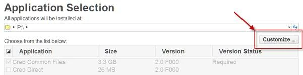

Oh, one more thing, If you have been using PTC's installers for years, it's not going to be apparent to you that there is a Customize button.
[cid:image002.jpg@01CD118D.52A8D670]
That brings up a dialog box with three tabs to allow you to select what gets installed for each of the components in the left column. Allows you to adjust your license configurations, and to decide if you want shortcuts on the desktop, or in the start menu. I typically don't install any shortcuts. You will need to do this for each of the items that is in the left column. So even though you don't install icons for Creo Parametric, You have to pick Creo Simulate and select what Icons you want for that.
