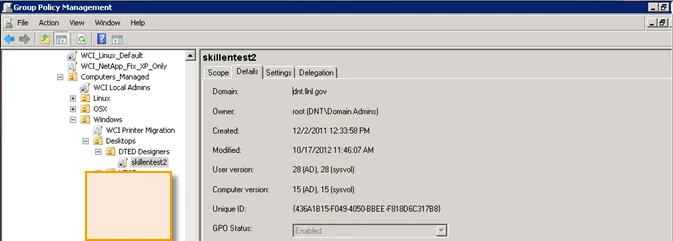

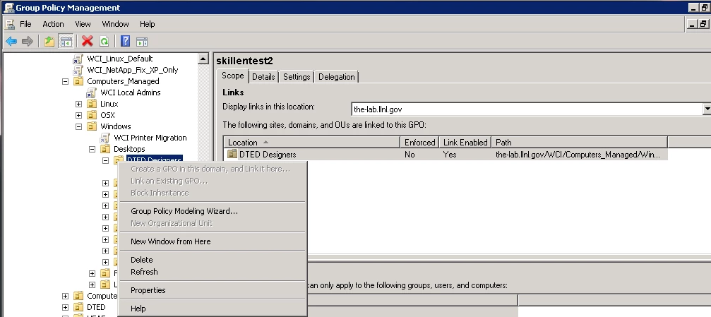

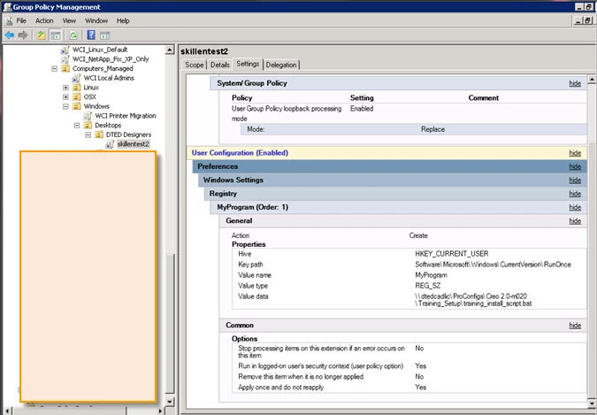

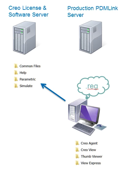

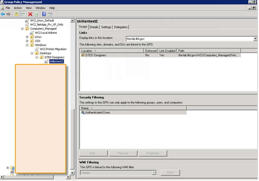

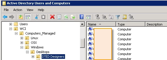

I wanted to weigh in here on the concept of just installing the software locally and then moving it up to the server.
That's bound to have performance problems because none of the paths that got set when the software was installed locally are correct for the server drive.
As others have pointed out there is an appropriate process for doing this so that all the internal paths and registry settings on the client computers are correct.
Now all of this is detailed in the appendix of the install guide, but it tends to leave out some important things. So since I've been responding to a number of folks about this issue. Here's my suggestions for how to do this.
Sorry about the length, this is the combination of several emails.

So you want to end up with this:
[cid:image001.png@01CDD2EE.371A1CC0]

Dec 6, 2012 5:28 PM UTC
The main reason I go through the process detailed in the apendex of the install guide is because we do not give admin rights to our users.
So, we need to install the local applications for them. Creoagent, CreoView Express, thumbviewer.dll, & CreoView.
The Silent install term comes from PTC. Essentially, they are just talking about a way to push the install out to the clients without any user interaction. You can push out a full local install of Creo using this method. I do that for laptops.
Registry Files
If you will look at the reg files you will see that it's defining...
file types:
[HKEY_CLASSES_ROOT\.asm]
@="asmFile"
Icons for those file types:
[HKEY_CLASSES_ROOT\creoFile\DefaultIcon]
@="P:\\/Creo 2.0/Parametric/install/nt/parametric.ico,0"
How to open those file types:
[HKEY_CLASSES_ROOT\creoFile\Shell\Open]
@="Open With Creo Parametric"
[HKEY_CLASSES_ROOT\creoFile\Shell\Open\Command]
@="\"P:\\/Creo 2.0/Parametric/bin/parametric.exe\" \"%1\"
Can you do without this? Sure, but the client is not going to behave like a machine that had Creo installed on it locally.
Batch Files
As for editing the .psf & .bat files in the install location. Sure you can do that, doing it my way I don't have to edit those files.
The .bat files give the path to the software, and tell it what psf file to read for license configuration:
@echo off
"P:\Creo 2.0\Parametric\bin\parametric.exe" "P:\Creo 2.0\Parametric\bin\Parametric1.psf" %*
The .psf file sets the license that was defined for that configuration.
When you've defined several license configurations, I find it simpler to install it on the proper drive letter first so I don't have to edit that stuff.

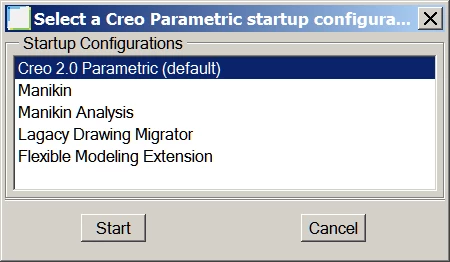

When my users startup they get the choice of several different licenses that they can run. Like this:
[cid:image001.png@01CDD38B.3A494E50]
These are all startup extensions, not floating options, so they have to be defined in their own configuration in order to be used.
