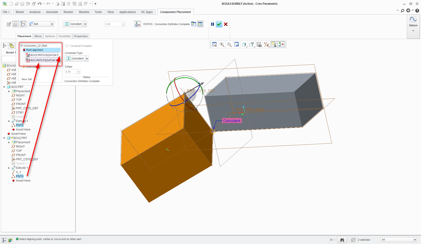

I am currently working on a project to get the geometry properties of joints within an assembly using ProToolkit. However, for Ball joints i am running into problems lately (should be the same for any other type of constraint, too).
When I select datum points as point alignment for the Ball Joint I get an error with bad inputs (line 8 of code below). If I use edges of the boxes instead, everything is working properly (code finishes).

My assumption is, that ProToolkit does not treat the datum point as a geometry feature. Is this true? How am I able to get the position of the Ball refence then, since any features within my part could be used as a geometry reference for that constraint.

I found a solution.
The problem is, that ProGeomitemdataGet() does not support ProModelitem with type PRO_POINT.
Instead I haveto check whether the type of the geometry found is a point or not and if it is a point gather the data using another way.
For me ProPointInit() and ProPointCoordGet() worked perfectly.
