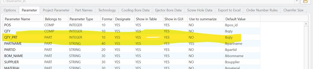

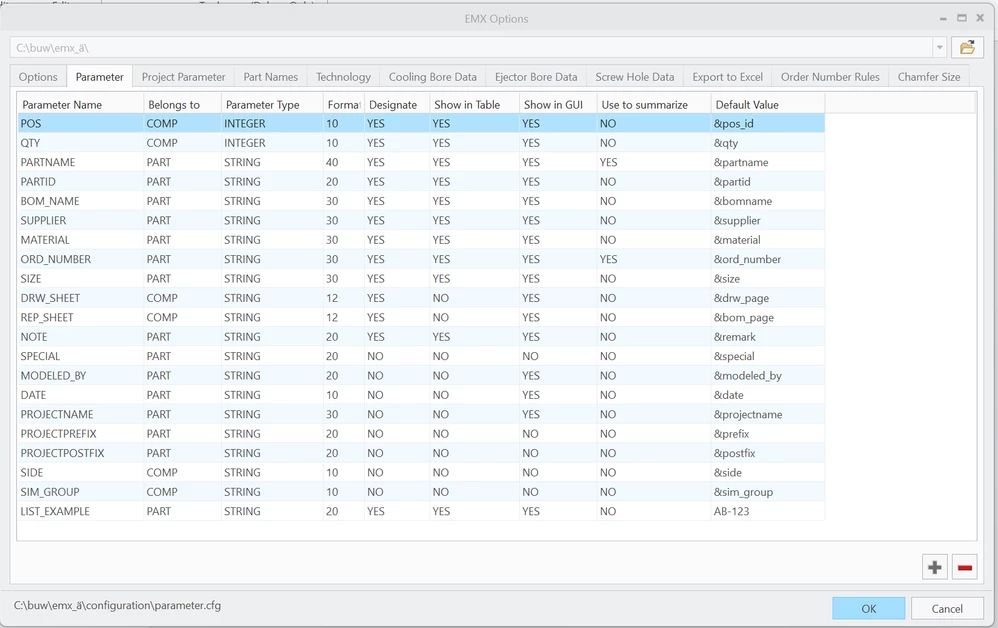

when using EMX out of the box the parameter setting looks like that. QTY has "Belongs To" defined as COMP.
This means it is a Component parameter. This makes totally sense, because a Quantity makes actually only sense in the assembly context.
Think it differently you can have a part in to different assembly with a differnet qty. This can only be achieved if the QTY is a component parameter.
And this is the reason why you will not find it one the drawing. A drawing only works with part parameters.
However, you can try out to add a new parameter line with mabye the name QTY_PRT and set the "Belongs to" to PART. Important: In the last column you have to select the default value rule &qty as well. What happens now is that the &qty rule will also be written to the part.
But: You have to be aware that in case you will work on another assembly/project  and you use same parts (With equal names) the part parameter value  could be changed.
It is a typical problem: Same happens with a position ID. This is also a value which can be different in assemblies, but people need it on the part.
