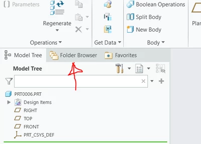

Hello , when I open Creo , Folder browser is opened in another window but I want it docked to Creo as per below image. I tried option of  File > Options > Window setting > Browser settings *un ticked expand browser during startup* which made the 2nd window containing Folder browser disappear without showing on creo tree. Basically I want this folder to appear as per below image.

The config.pro option web_browser_in_separate_window controls this.
https://www.ptc.com/en/support/article/CS41071
