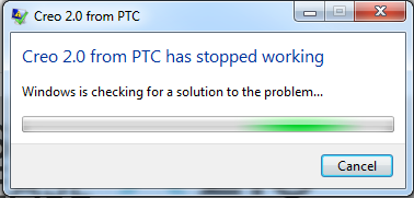

I'm getting a problem on Windows 7 Pro 32 bit machines and installing Creo Parametric 2.0
Creo installs fine and then on launch it installs pvx and the Creo Agent 2.9, the I see a message dialogue saying that "Creo 2.0 from PTC has stopped Working" You can cancel this error message and Creo runs fine.
I contacted PTC Tech Support who are looking into this and from them they suggested to uninstall the creoagent and change the name of the installer file in <CREO_INSTALL>\Common Files\M010\install\addoncreoagent_32.msi to .old This will stop Creo from being able to install the agent,
This is fine accept that it stops things like the learning connector working

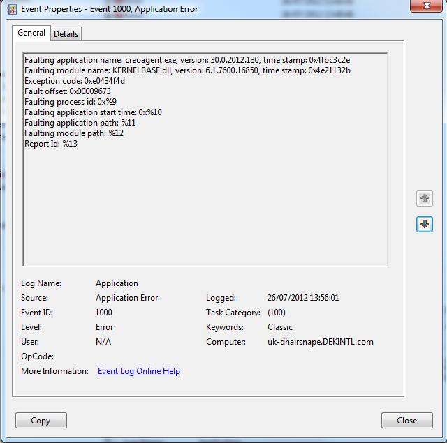

Looking at the Windows Event logs I see the error pointing to KERNELBASE.dll
Anyone got any ideas as to what is causing this
I've tried re-installing creo several times and ensuring there are no creo reg entries or files left anywhere on teh machine

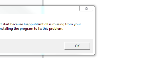

I also found another log file showing an error
So I am now stumped as to what is the real issue. Any one seen this or can help it would be really useful if they could let me know what they did or how far they got with it
Aug 7, 2012 1:39 PM UTC
Thanks to all that replied
PTC TS have told me that "The Issue is reproduced in Windows 7 32 Bit and an SPR will be opened to address this"
So hopefully a fix in M020 or M030, think its got to be high on the fix list if they want to showcase the Learning Connector.
This is the Creo Platofrm 2.9 Agent that runs NOT the Quality Agent just so we aare clear on this.
Stopping this Creo Platform stops the learning connector

Jul 26, 2012 3:30 PM UTC
When I installed Creo 2.0 M010, It had a checkmark for not installing, or at least not running the agent. I think it worked. I am on Windows 7 64bit.
