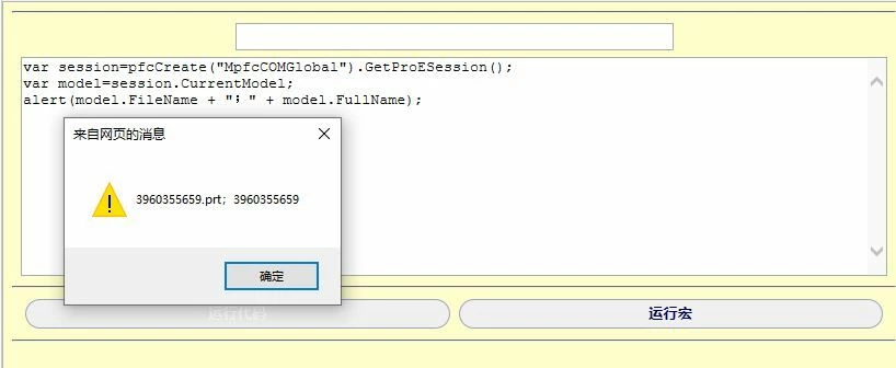

MurphyMin12-AmethystAuthor
June 18, 2020
  1. Get creo Session in weblink  MpfcCOMGlobal.GetProESession()
ActiveXObject method to create class in weblink
function pfcCreate (className)
  if (pfcIsWindows())
    return new ActiveXObject ("pfc."+className);
  else if (pfcIsChrome())
    return pfcCefCreate (className);
  else if (pfcIsMozilla())
    netscape.security.PrivilegeManager.enablePrivilege("UniversalXPConnect");
    ret = Components.classes ["@ptc.com/pfc/" + className + ";1"].createInstance();
    return ret;
2.Get current working directory and change it
June 18, 2020
Get model info in session
