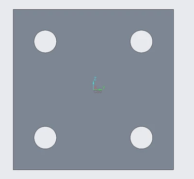

that is a view I'm getting when i input any kind of matrix. Even normalized

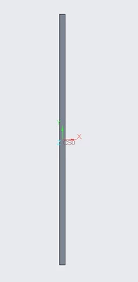

this is view it has to give to me
