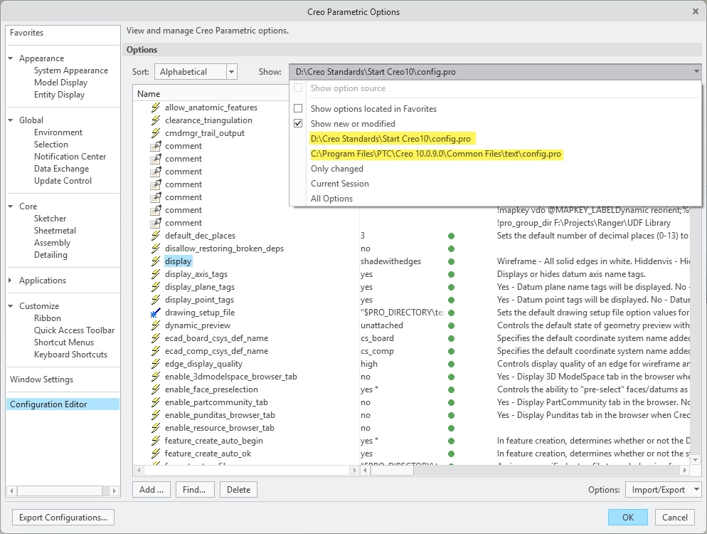

You can get some insight into what is being loaded by looking at the file(s) listed in the options UI as shown below.

and placed my config.pro file in C:\Users\LSun10, and it fails to read it. It only reads the default system level config files:
It just seems that the articles are stating a functionality that does not actually work as intended, but if I am doing something wrong, please let me know.
