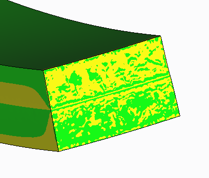

I’m pretty new to Creo and Creo Simulate, and I’m using Creo Simulate to look at the stress distribution in a bimetal rectangular beam.
The bottom half of the beam is aluminum, and the top half is steel. The halves are bonded together. The entire beam is heated from 20 degrees C to 200 degrees C. The left side of the beam is fixed in the X direction.
This results window shows the XX stress in the beam. The green regions are negative (compression) and the yellow regions are positive (tension).

If you rotate the beam to look at its right side:
Here the stress distribution looks “blotchy.”
Should I expect the stress in the beam to be uniform throughout? Or is it normal that the stress gets complicated at the end of the beam, on the right side?

Alu expands more than steel, but they are connected. At the interface there will be an equilibrium in displacements. The steel is holding back the alu from expanding on that side, while the alu helps the steel expand more on that side. If you cut the system into two separate beams, one of alu and one of steel, you now have a case of a beam fully constrained on the left side, and with a distributed load in axial direction on one side of the beam. Each beam will curve, and so each of the beams will have a neutral line, a compressive stress side and a tensile stress side. So that explains the striped flag effect.
At the unconstrained end of the beam, there can be no stress in axial direction, because the material ends in air, and air is not a very stiff medium. So the axial stress at the free end must be zero. That is your "blotchy" stress distribution. I'm sure the stress values there are all near-zero.
Remains the transition from the flag to zero. That is not so easy to explain. But since FEA did so well in the other bits, I trust that this is actually what the transition looks like. Very interesting!

Good job explaining the situation- I think your explanation helped me to better understand what's going on. When I look at the stress values at the surface of the free end, most of them are very close to zero, which makes sense. Thanks for your response!

It looks as if you have 2 colours in the stress plot legend. If the stress level is even and at/near a colour interface some areas will be one colour, other will have another colour. If you change the legend's max/min's so that it goes from min to max for the "blotchy" area, it might not look so blotchy anymore.

You are correct- at the color interface between green and yellow the stress value is 0, and for most of the free end surface, the stress is very close to 0. So that's what causes the blotchiness. When I edit legend values, that gets rid of the blotchiness. Thanks for your response!
