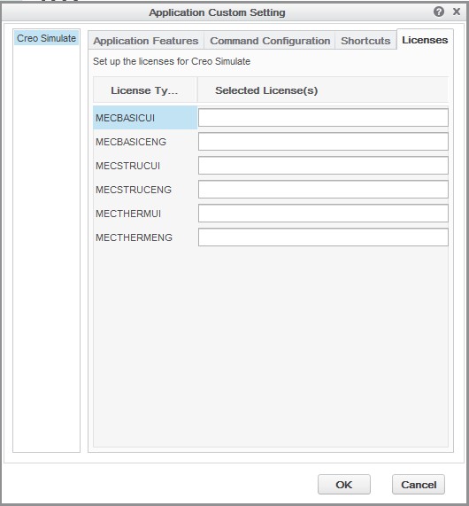

Hi, i am a company user of Creo2.0 with floating license. I am trying to configure the Creo Simulate with reconfigure.exe which in folder C:\Program Files\PTC\Creo 2.0\Simulate\bin, but in "Licenses"tab all the fields are not editable, I can't fill in anything into theses fields. A screenshot of this is shown below. Can anyone tell me how to solve this issue? Thanks.

Jarvis,
using reconfigure.exe = wasting a time.
You have to choices.
1.] fully deinstall Creo, install it from scratch and use Configure button to enter Simulate licenses
-OR-
2.] edit feature.dat file
In my installation, the path to the file is ... C:\PTC\Creo2_M070\Creo 2.0\Common Files\M070\mech\text\licensing\mech\feature.dat. The example of file contents follows.
MEC_BASIC_UI "MECBASICUI_License"
MEC_BASIC_ENG "MECBASICENG_License"
STRUCT_UI "<No license features>"
STRUCT_ENGINE "<No license features>"
STRUCT_THERMAL_UI "<No license features>"
STRUCT_THERMAL_ENGINE "<No license features>"
Info mentioned in point 2.] is accessible in CS108204 and CS188275.
